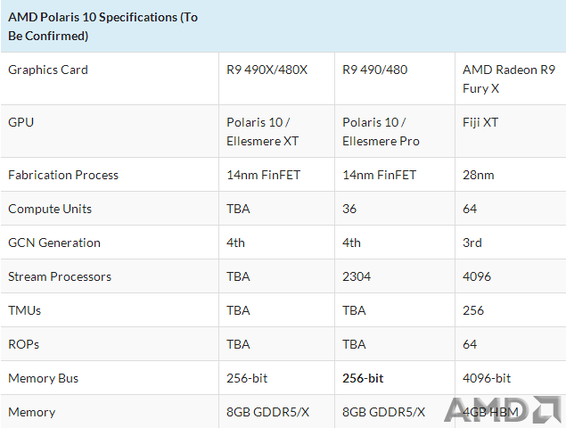

AMD Polaris 10 GPU Specs Leaked – Features 8GB VRAM & 256bit Bus
AMD 北极星 10 GPU 参数爆款 – Features 8GB VRAM 加上 256bit 总线
The SiSoft entry points to an 8GB GDDR5/X, 256bit GPU with 2304 4th generation GCN cores. Interestingly this is the exact same memory capacity & bus configuration we’ve seen on Nvidia’s upcoming GP104 Pascal based GTX 1080 & GTX 1070 graphics cards.
从SiSoft的数据我们得出北极星10是有8GB GDDR5(X)256bit,有2304个GCN核心。有趣的是这和老黄的使用GP104帕斯卡核心的GTX 1080和 1070显卡的配置拥有相同的显存和总线。
This particular Polaris 10 chip carries the 0x67DF device ID, which according to AMD’s recently released driver source code indicates that we’re likely at the cut down variant of Polaris 10. So this is likely the Polaris 10 configuration that we’re going to end up seeing as the R9 490 or R9 480.
这个特殊的北极星10芯片的设备ID是0x67DF,根据AMD最近发布的设备源码表明这个可能是阉割过的北极星10,所以这更像是R9 490或R9 480的参数。
The full Polaris 10 deviceID being 0x67C0 and likely sporting 2816 GCN cores like Hawaii XT. The driver source code also confirmed that Polaris 10 is indeed Ellesemere and Polaris 11 is Baffin. Both of which are Arctic Islands GPU code names that we had covered extensively.
完整的北极星10设备ID是0x67C0,他有就和Hawaii XT一样有2816个GCN和核心。根据设备源码可知北极星的代号可能是Ellesemere(埃尔斯米尔岛),北极星11的代号可能是Baffin(巴芬岛)。链接里是北极的各个岛屿……
There’s no entry for the full Polaris 10 chip in the database just yet so we don’t know how many GCN cores it will feature. However, seeing as how the R9 390 & 390X perform remarkably close to each other AMD will have likely decided to create a wider space between the full Polaris 10 chip , Ellesmere XT, and the cut down Polaris 10 chip, Ellesmere Pro. But it’s anybody’s guess right now.
但是在数据库了没有完整的北极星10芯片记录,所以我们并不知道有多少GCN核心。但是根据R9 390和R9 390X的性能差距,AMD似乎会拉开完整的北极星10、Ellesmere XT和阉割的北极星10、 Ellesmere Pro之间的差距。但是现在谁也说不准。

The SiSoft entry also includes the clock speed of the card, which at 800Mhz is surprisingly low. So we’re likely looking at an early engineering sample here. Especially considering the fact that 14nm FinFET clocks much higher than 28nm. So I’d expect frequencies upwards of ~1150Mhz on the production chips.
在SiSoft出现那条记录显示显卡的主频只有很低的800Mhz,所以这很有可能是工程卡。加之14nm FinFET的主频比28nm的要高,所以我们认为成品的主频将会在1150Mhz左右
With that in mind, the GPU actually did well in the benchmark and came ahead of the GTX Titan Black. Which features a full GK110 chip and coincidentally is faster than a 2816 GCN core Hawaii XT GPU. Also funnily enough this is very close to the performance we’ve seen from the leaked GTX 1080 and GTX 1070 benchmarks.
如果考虑这一点的话,GPU将会在基准测试中超越GTX Titan Black。它采用的GK110芯片会比2816个GCN核心的Hawaii XT更快。我们发现这个基准测试的结果非常接近之前泄露的GTX 1080和GTX 1070。
Despite the low clock speed & the lower number of GCN cores this particular configuration of Polaris 10 still performed ahead of where you’d expect an R9 290X to perform. This in turn indicates that 4th generation GCN cores perform measurably better per clock than their predecessors.
尽管这个特别的北极星10的主频和GCN核心很少,但是它的性能仍比R 290X要高。这表明GCN4.0的效率比前任的要高。
Also worthy of note is that this Polaris 10 engineering sample features 6Gbps GDDR5 memory chips rather than GDDR5X which combined with a 256bit bus delivers 192GB/s of bandwidth. Exactly half the memory bandwidth of the R9 390 and 390X, which indicates that production Polaris 10 cards could feature 12Gbps GDDR5X memory instead to deliver the same amount of bandwidth.
这块工程卡同样值得关注的方面还有显存。它采用的是6Gbps的GDDR5而不是256bit总线 192GB/s带宽的GDDR5X。这正好是R9 390和390X一半的带宽,有可能会表明这北极星10的卡可能会用12Gbps GDDR5X来达到相同的带宽。
