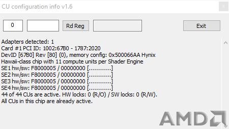

开发的新工具——CUINFO tx12从Overclock.net论坛,让你看到哪些计算单位启用或禁用AMD图形处理器。
这意味着现在可以看到哪些计算引擎 到底 是禁用的。 一些客户只是硬件锁,人有缺陷或激光切割,不能解锁。 这个工具会告诉有多少可以解锁定制的BIOS。

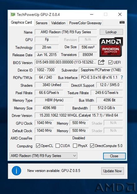

然而,如果该工具告诉您,您的信用卡是没有上锁,输出只会显示右边的列禁用,然后你可以增加流处理器数到3840。
RV8000 是第一个做到这一点:

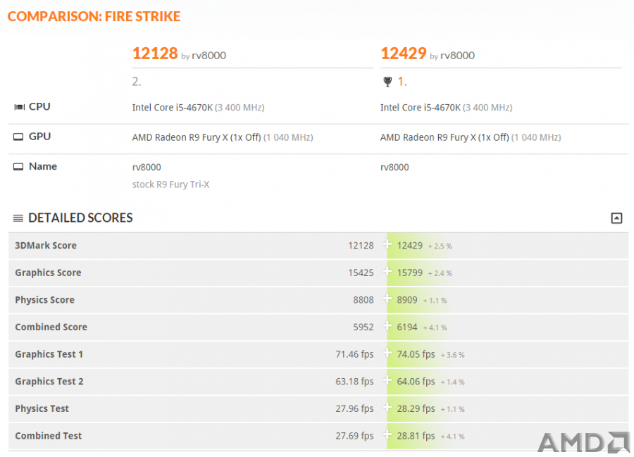

这里有一个证明3 dmark火罢工,运行在同一时钟速度。

RV8000 was first to accomplish this:
Here’s a proof in 3DMark Fire Strike, running at the same clock speed.

3. Get a cuinfo report and examine the status and dotted map:
For Fiji, report should be like: "8 CU's are disabled by HW lock, override is possible at your own risk.".
If it says "Sorry...", you're out of luck.Code:
SE1 hw/sw: 00050000 / 00000000 [.............x.x]SE2 hw/sw: 00030000 / 00000000 [..............xx]SE3 hw/sw: 00030000 / 00000000 [..............xx]SE4 hw/sw: 00030000 / 00000000 [..............xx]56 of 64 CUs are active. HW locks: 8 (R/W) / SW locks: 0 (R/W).8 CU's are disabled by HW lock, override is possible at your own risk.
In general, you can try to unlock some cores ONLY if you have at least one of the two rightmost columns filled with 'x'-es. On this example map, rightmost column (#1) is filled with 'x'-es only, but second (#2) is not.
If none of the two rightmost columns is filled with 'x', you're most probably out of luck and shouldn't try this unlock method. Or just try all the roms to catch some luck (not recommended).
NOTE: all x'es in the column DOES NOT guarantee you a safe and successful unlock.
